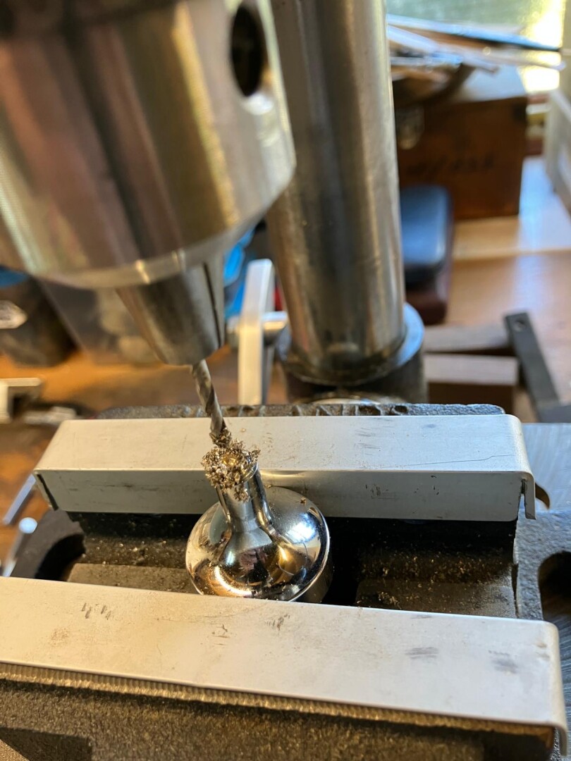

The knob was drilled to 12mm depth, starting at 2.5mm dia and working incrementally up to 5mm dia. The swarf revealed the material to be brass.

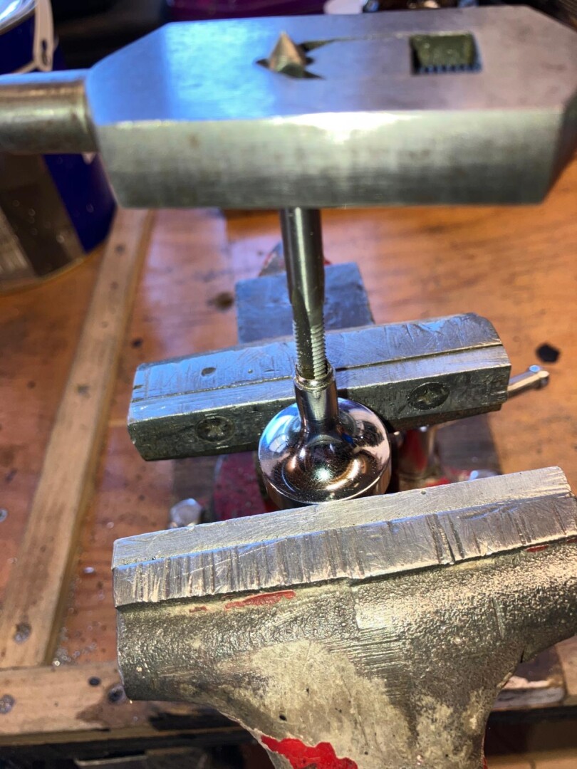

An M6 thread was then cut to full depth.

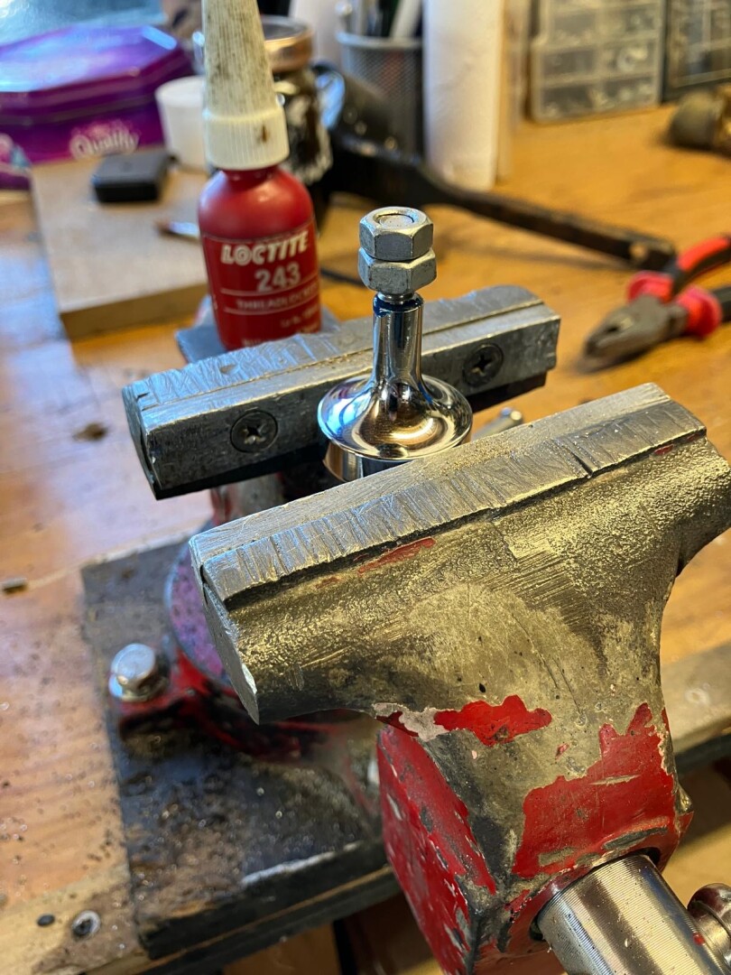

A 25mm length of stainless M6 threadbar was screwed into the newly cut hole, sealed with threadlocker and tightened.
This assembly was then screwed into the sliding plate to enable the bonnet catch to be released. A washer and stainless nyloc nut clamp the knob to the sliding plate, thus making a connection somewhat stronger than the previous arrangement. Job done.
