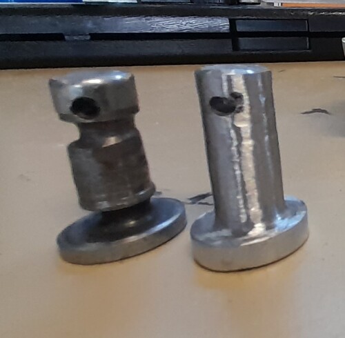

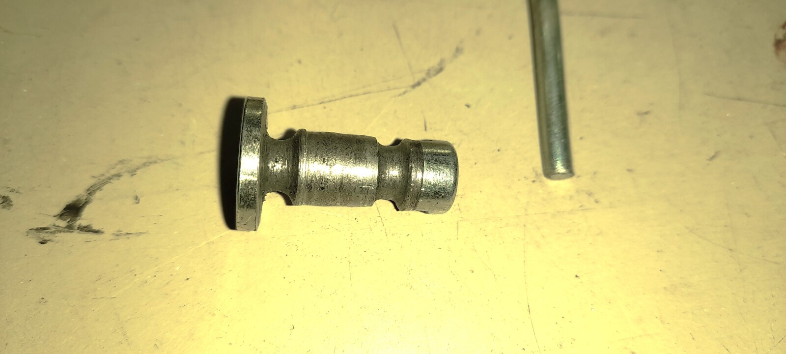

This was the cause of the play, axle half worn away.
So, looking for a new spring and axle.

I made a new axle myself and the play on the pedal is gone, perfectly drivable without a spring.

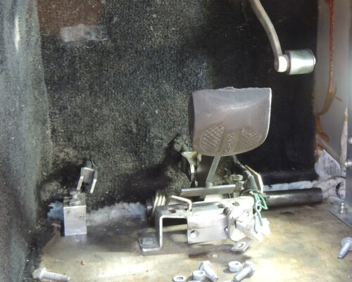

During assembly I saw that the brake pedal also has a righthand spring but can also be provided with a lefthand spring.
[Linked Image] [Linked Image]
Got a left spring from Belmog and exchanged it with the clutch and everything is back the way I like it, although it was a bit hectic.
